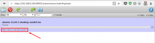

I have a strange bug with all versions of qtransmission (arm) on latest QTS 4.3
Qtransmission shows incorrect progress in %% (WEB UI) when downloading. :?
There are only two states 0% and 100%.
Any ideas?
