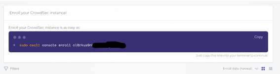

-On vous proposera ensuite d'enregistrer une instance à l'aide d'une commande:
En SSH, exécuter la commande suivante:
docker exec -t crowdsec cscli console enroll cl8rkusxxxxxxxxxxxxxxx

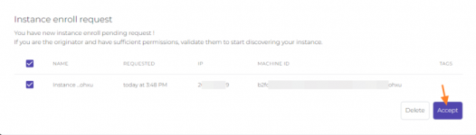

-Retourner ensuite le site de https://app.crowdsec.net/ et cliquer sur "accept" pour enregistrer l'instance.

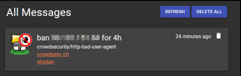

a/ Être notifié via Gotify
Dans le dossier notifications de Crowdsec, nous allons créer un fichier gotify.yaml :
nano crowdsec/crowdsec-config/notifications/gotify.yaml
Dedans, nous placerons ce contenu :
YAML:
type: http          # Don't change
name: gotify  # Must match the registered plugin in the profile
# One of "trace", "debug", "info", "warn", "error", "off"
log_level: trace
# group_wait:         # Time to wait collecting alerts before relaying a message to this plugin, eg "30s"
# group_threshold:    # Amount of alerts that triggers a message before <group_wait> has expired, eg "10"
# max_retry:          # Number of attempts to relay messages to plugins in case of error
# timeout:            # Time to wait for response from the plugin before considering the attempt a failure, eg "10s"
# plugin-specific options
# The following template receives a list of models.Alert objects
# The output goes in the http request body
format: |
  {{ range . -}}
  {{ $alert := . -}}
    "extras": {
      "client::display": {
      "contentType": "text/markdown"
  "priority": 3,
  {{range .Decisions -}}
  "title": "{{.Type }} {{ .Value }} for {{.Duration}}",
  "message": "{{.Scenario}}  \n\n[crowdsesc cti](https://app.crowdsec.net/cti/{{.Value -}})  \n\n[shodan](https://shodan.io/host/{{.Value -}})"
  {{end -}}
  {{ end -}}
# The plugin will make requests to this url, eg:  https://www.example.com/
url: https://gotify.ndd/message?token=<MON_TOKEN>
# Any of the http verbs: "POST", "GET", "PUT"...
method: POST
headers:
   Content-Type: application/json
#   Authorization: token 0x64312313
# skip_tls_verification:  # true or false. Default is false
Dans ce fichier gotify.yaml, vous allez devois personnaliser une ligne : url: https://gotify.ndd/message?token=<MON_TOKEN>
- https://gotify.ndd est a remplacer par l'url de votre instance gotify
- <MON_TOKEN> est a remplacer pour le token que vous aurez généré dans l'onglet APPS de Gotify
Enregistrer le fichier, et quitter ( Ctrl + X )

Puis on redémarre le conteneur CrowdSec pour que les modifications soit prisent en charge : docker restart crowdsec
Le résultat sur Gotify :
