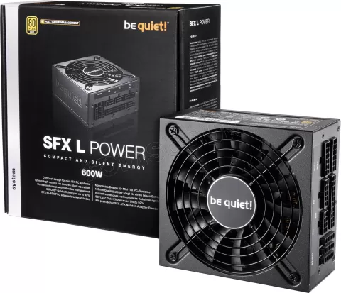

Alimentation : be quiet! SFX-L Power - 600W
