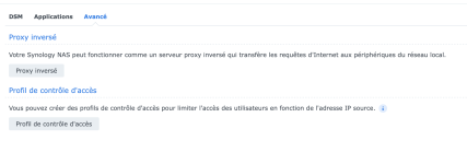

Dit, j'ai mis dans certains .conf une restriction d'ip comme ceci :
NGINX:
## ACL.IP-LAN.conf
# For my Synology DSM, I created an Access Control Profiles to restrict access only to LAN and VPN IP adresses
# This Access Control Profile is a file in the /etc/nginx/conf.d folder
# But for SWAG-Nginx, it must be with another file.
# Allow all from LAN IPs
allow 192.168.2.0/24;
# Allow all from VPNs IPs
allow 192.168.10.0/24;
allow 192.168.11.0/24;
# Deny all
deny all;
via une ligne : include /config/nginx/ACL.IP-LAN.conf;
