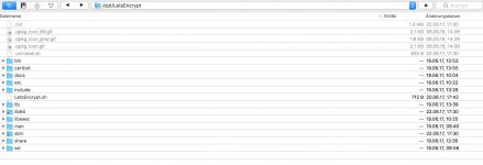

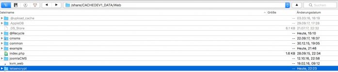

Hello everybody,
I am gonna need some help. I have the Qnap firmware 4.3.3 and LetsEncrypt 0.6 installed.
I wanted to generate some certifificates put it is just not working
[/opt/LetsEncrypt/bin] # ./letsencrypt certonly -t --webroot -w /share/CACHEDEV1_DATA/Web/letsencrypt -d 192.168.178.24:8243/sabnzbd/
-sh: ./letsencrypt: No such file or directory
Does someone can help me? What am I missing?
