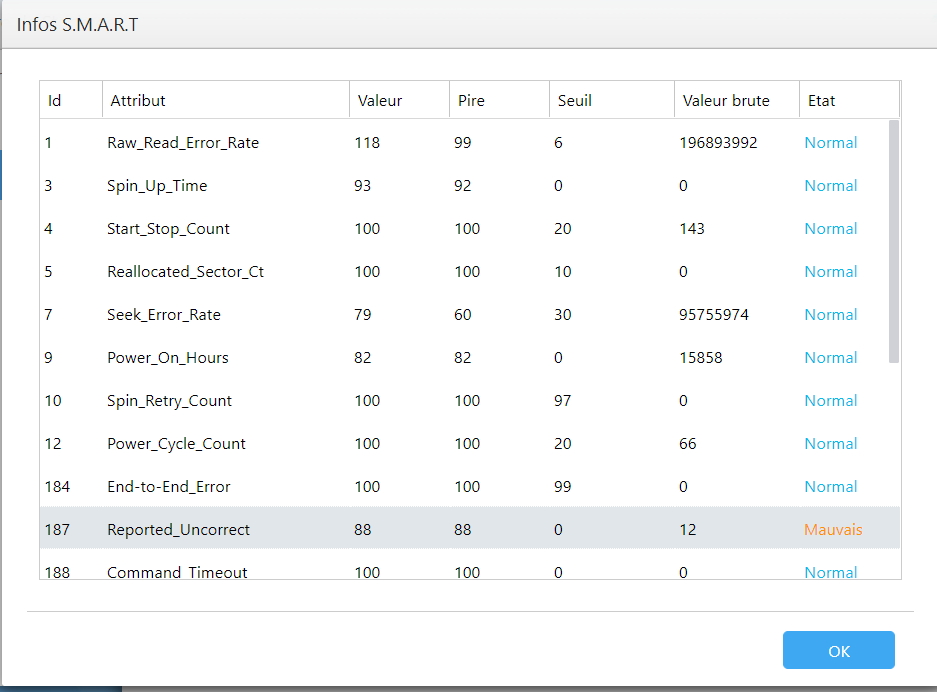

J'ai lancé un docteur de disque sur le disque defectueux :
resultats:
Aucun secteur défectueux trouvé (01/11/2019 )
SMART: mauvais
ETAT: BON
Comment ca peut etre bon et mauvais en meme temps ? :-D

Edit le SMART tu verras le problème.

j'ai bien editer les infos smart, mais ca me parle pas:
Id 187
Reported_Uncorrect
Valeur: 88
Pire: 88
valeur brut: 12
Mauvais

SMART 187: Reported_Uncorrect –
Backblaze uses this one.
Number 187 reports the number of reads that could not be corrected using hardware ECC. Drives with 0 uncorrectable errors hardly ever fail. This is one of the SMART stats we use to determine hard drive failure; once SMART 187 goes above 0, we schedule the drive for replacement.
This first chart shows the failure rates by number of errors. Because this is one of the attributes we use to decide whether a drive has failed, there has to be a strong correlation:
The next question you might ask is: How many drives fall into each of those ranges? That’s answered by the next chart:
This looks at the full time range of the study, and counts “drive years”. Each day that a drive is in one of the ranges counts as 1/365 of a drive year for that range. Those fractions are all added up to produce the chart above. It shows that most of the daily samples show drives without errors.
For SMART 187, the data appears to be consistently reported by the different manufacturers, the definition is well understood, and the reported results are easy to decipher: 0 is good, above 0 is bad. For Backblaze this is a very useful SMART stat.
Plus d'infos avec graphiques : https://www.backblaze.com/blog/hard-drive-smart-stats/

J'ai compris que le disque va lacher, on ne sait pas quand mais il va lacher ;)
