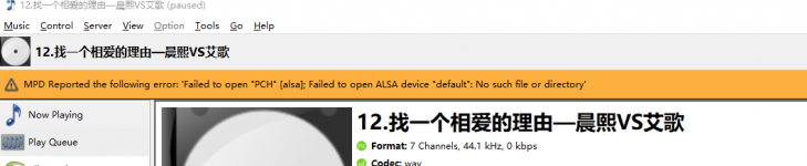

Apr 05 15:40 : exception: Failed to open "My ALSA Device" [alsa]
Apr 05 15:40 : exception: nested: Failed to open ALSA device "hw:0,0": No such file or directory
ALSA lib pcm.c:2495:(snd_pcm_open_noupdate) Unknown PCM hw:1
Apr 05 16:37 : exception: Failed to open "My ALSA Device" [alsa]
Apr 05 16:37 : exception: nested: Failed to open ALSA device "hw:1": No such file or directory
ALSA lib pcm.c:2495:(snd_pcm_open_noupdate) Unknown PCM hw:0
Apr 05 16:41 : exception: Failed to open "My ALSA Device" [alsa]
Apr 05 16:41 : exception: nested: Failed to open ALSA device "hw:0": No such file or directory
Apr 05 17:18 : exception: Failed to commit /opt/MPD/var/lib/mpd/state: No such file or directory
Apr 05 17:19 : exception: Failed to open "My ALSA Device" [alsa]
Apr 05 17:19 : exception: nested: Failed to open ALSA device "default": No such file or directory

QNAP 4.3.6.0895 MPD How to configure sound output?
audio_output {
type "alsa"
name "pcm"
# device "hw:0,0" # optional
mixer_type "software" # optional
mixer_device "hw:0,0" # optional
# mixer_control "PCM" # optional
# mixer_index "0" # optional
QoolBox a dit:
it is not for local use but for a remote client on your PC
PC can't play
Is there any way to follow
QNAP audio line out
    40.6 KB · Affichages: 1 175
