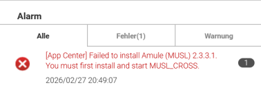

puis en essayant d'installer AMule, j'ai obtenu l'erreur suivante :

please forget my last message - I managed now to do this by
a) installing the qpkg MUSL packages - MUSL_CROSS first,
b) then via SSH running MUSL.sh start,
c) installing MUSL2025
d) via SSH running env.sh and MUSL.sh start.
Sorry for the bother, and thanks for the packages!
