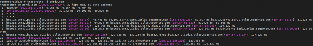

Je te donne un exemple de traceroute chez moi sur l'un de mes réseaux : Mon device passe par mon routeur en 192.168.0.245, c'est l'adresse interne de mon routeur.
root@odroidc2:~# traceroute -d perdu.com
traceroute to perdu.com (208.97.177.124), 30 hops max, 60 byte packets
 1  gateway (192.168.0.245)  0.966 ms  0.854 ms  0.784 ms
 2  194.149.169.33 (194.149.169.33)  39.172 ms  39.891 ms  39.829 ms
 3  * * *
 4  * * *
 5  be2102.ccr41.par01.atlas.cogentco.com (154.54.61.17)  48.741 ms be2103.ccr42.par01.atlas.cogentco.com (154.54.61.21)  50.097 ms be2102.ccr41.par01.atlas.cogentco.com (154.54.61.17)  51.126 ms
 6  be2318.ccr32.bio02.atlas.cogentco.com (154.54.61.117)  64.824 ms be2315.ccr31.bio02.atlas.cogentco.com (154.54.61.113)  51.426 ms  52.668 ms
 7  be2331.ccr41.dca01.atlas.cogentco.com (154.54.85.241)  125.795 ms  122.837 ms be2332.ccr42.dca01.atlas.cogentco.com (154.54.85.245)  119.622 ms
 8  be3084.ccr41.iad02.atlas.cogentco.com (154.54.30.66)  125.872 ms be2658.ccr22.iad02.atlas.cogentco.com (154.54.47.138)  122.601 ms be3084.ccr41.iad02.atlas.cogentco.com (154.54.30.66)  128.569 ms
 9  be3563.rcr51.b037327-0.iad02.atlas.cogentco.com (154.54.25.226)  129.838 ms  130.254 ms be3562.rcr51.b037327-0.iad02.atlas.cogentco.com (154.54.24.234)  127.227 ms
10  38.122.62.254 (38.122.62.254)  132.156 ms  124.154 ms  123.604 ms
11  iad1-cr-2.sd.dreamhost.com (208.113.156.58)  123.753 ms  125.861 ms iad1-cr-1.sd.dreamhost.com (208.113.156.208)  123.483 ms
12  ip-208-113-156-14.dreamhost.com (208.113.156.14)  120.865 ms ip-208-113-156-49.dreamhost.com (208.113.156.49)  125.352 ms  126.137 ms
